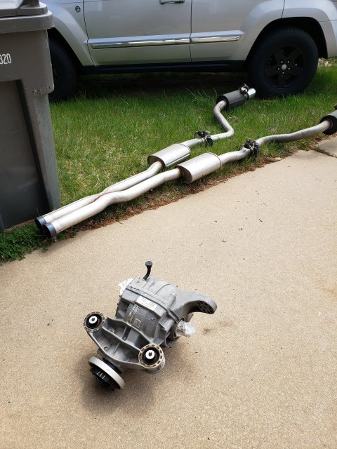

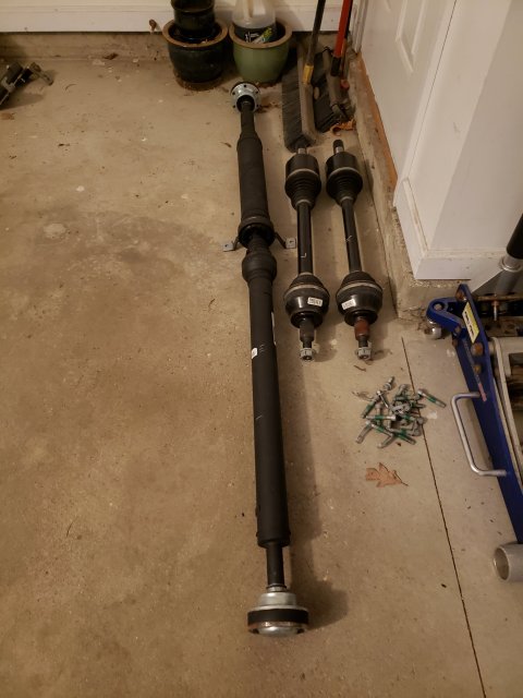

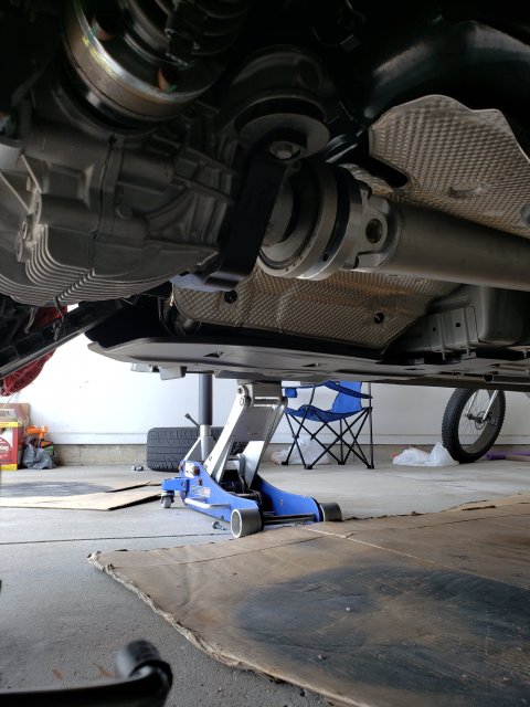

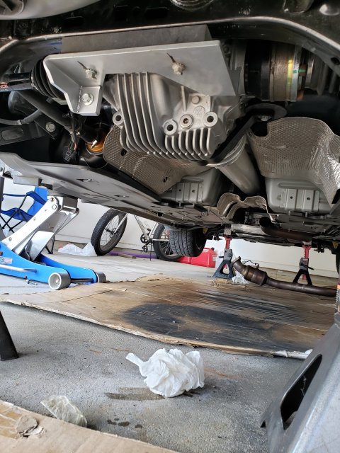

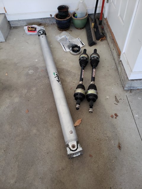

So today I decided to install my 3.09's which I bought used before I even owned a Hellcat because I thought I may want to try them. They only had 1500 miles on them. I picked up a used DSS aluminum driveshaft last summer and a few week ago bought some Gforce axles from the same guy I bought the rear from. Doing them all at once makes the most sense being they are all connected. You have to drop the exhaust for the driveshaft and rears and doing just the axles you have to disconnect the arms and brakes. The axles are only held on with one nut and come out the center so with no rear in place they come right out without taking the other stuff apart. Took the driveshaft off first then the rear and the axles. Reverse back together and also add the front brace. I started around 10 and Nick didn't make it over until 11:30 and we were done around 4. So 6 hours, probably 5 if he would have been there at 10

Wait you do have a Per4mance Brace right?
Best Peace of mind mod!
Linda :)
55,934
189,511
Linda :)
Yes in the pics. I'm planning on upgrading to the DIRS

Nice! I was waiting to see your post on this. I must have missed it last night.
I’m curious what you see from the 3.09. The 2.62 is why I decided to not go with the 315 50 r17 because the tire would have been so much taller.
You had the exhaust off too why didn’t you do that while you were at it?

Could you post a picture of the part numbers on the axles you removed? You interested in selling them?
55,934
189,511
Keeping the parts that came off. Never know if I may need them

I like my car quiet. I have Hooker blackheart exhaust sitting in the basement that came off my Daytona. I would put the valves in if I were to put it back on. They don't come on it

Thread Starter #11
@16GoManGoHC2 I saw you picked up some redeye axles. How come you don't buy some aftermarket ones?

At the price he scored them why not have a spare set?

I'm thinking aftermarket and you shouldn't have to worry about them breaking

I have DSS stage 5 1400 HP axles, my second set, 3rd rebuild, for me they don’t last. So I bought these RE ones for 3 reasons, I’ve heard their just as strong as the DSS ones, they where 1/3rd the cost, plus they’ll make good spares to try next time the DSS ones have to go back for new CV’s. If your spending big money on axles I’d try GForce Outlaws next, they make their CV’s out of their own design alloy, DSS uses off the shelf Porsche CV’s, their just not hard enough and develop ‘dents’ in them where the balls ride loaded up and start clicking and vibrating in no time for me at least. And I’m not lowered or nothing, just adjusted to 0 camber. Add to that DSS’s latest blue boots don’t last long either And they don’t warrantee boot failure even if they fail in the first month of operation, ask me how I know :(

For what I heard about the DSS is why I wanted the gforce

I also picked up some used 1k RE / Demon axles, 1/2 price. Perfect for my hp level.
