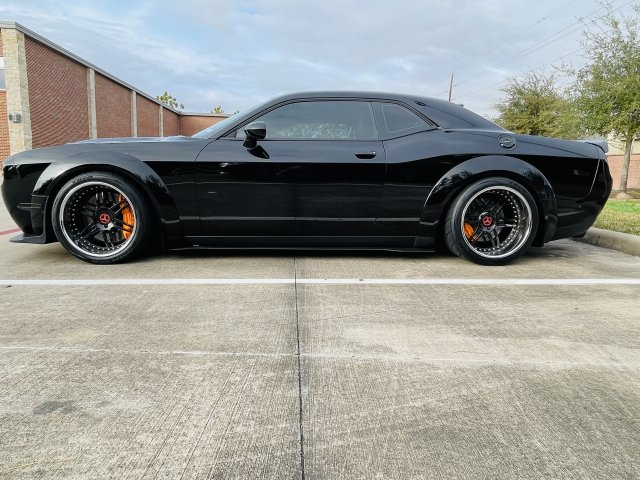

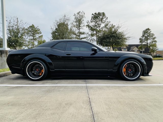

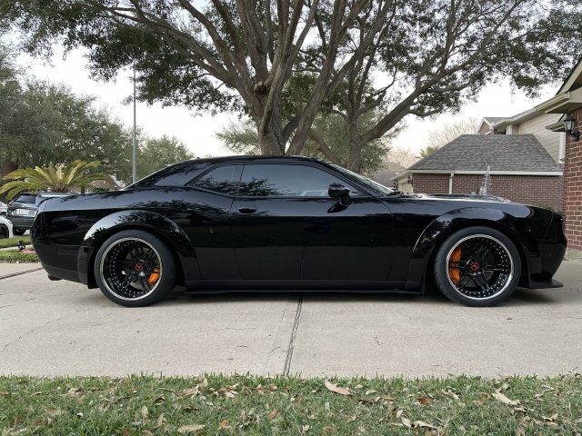

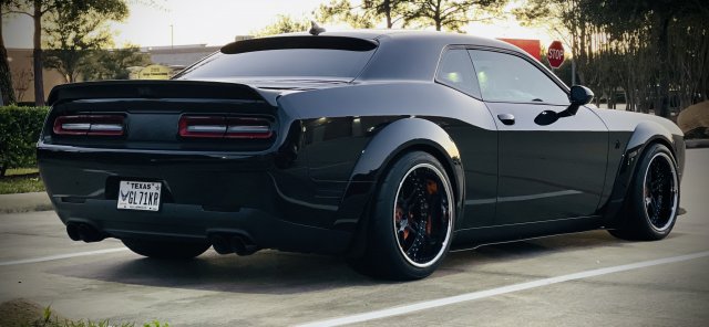

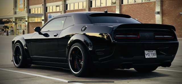

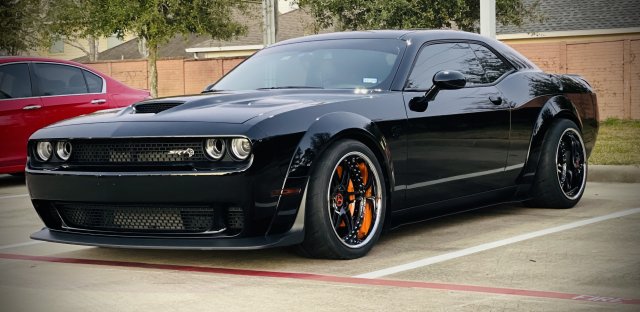

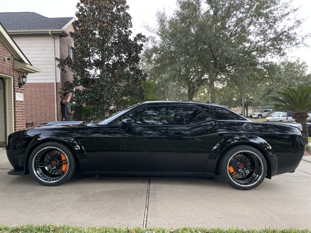

20x12 20x13.5 installed.

I always thought Dolly Parton was a bit over the top, so to speak.
But this is an extreme I can covet!
Badass is correct!
Badass is correct!
Lol, thank you. Dolly has big tits my girl has big lips!!

Bad a** shoes!

What size tire are you running in the rear?
20,161
has to be about 345 or so. Looks great man.

I do not recognize the tread pattern for a 345. I have 12s in the back with a 345 corsa. Still lets loose at 75. I wish they made a drag radial in a size larger than the 315 35 20.
20,161
Toyo R888R I believe
Tires are 325/30/20. Toyos R888R run wide.
Thank you. ToyoR888R 325/30/20

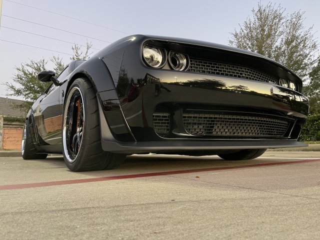

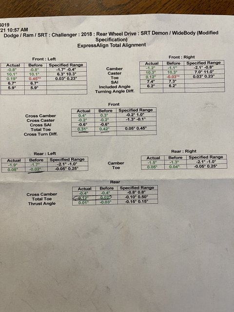

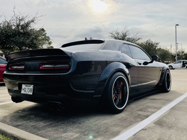

Finally completed the AAD drag pack and installed the Trail/Toe arms. No more wheel hop and being able to adjust toe while car is on lift is worth the $$$ for the arms. Got the stance on point. Maxed out the front drop and adjusted the camber. 218C537A-6C87-4FB7-8248-7D24C8BBD162.jpeg 8CC2B9E2-0D6D-4DAD-A131-3EC73FFDBD76.jpeg D332CF9C-83F7-403B-A132-54B3538E5909.jpeg A7B7CCDB-0D7C-4C1A-9621-FB506BE5BAE5.jpeg
