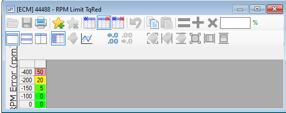

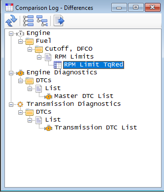

A few people have asked for changes after the cat recall flash. The answer is really no change as far as the flash goes but the potential to maybe reduce even more torque. This explains why @moparjim still had so many issues after the update. Anyone curious around 0 DA I saw @vortecd 100% stock car hit 98% injector duty cycle on more than one pass. I can't remember off the top of my head but the car was going for .68 or .7x lambda something on full throttle and the fuel couldn't keep up. This was pre cat recall we won't be doing any testing before we tune post recall. No point @moparjim did that and there were no improvements.
@vortecd let me pull a stock file before and after the update.
After cat update
Before cat update
Comparison. The DTC show a difference but I didn't see anything
