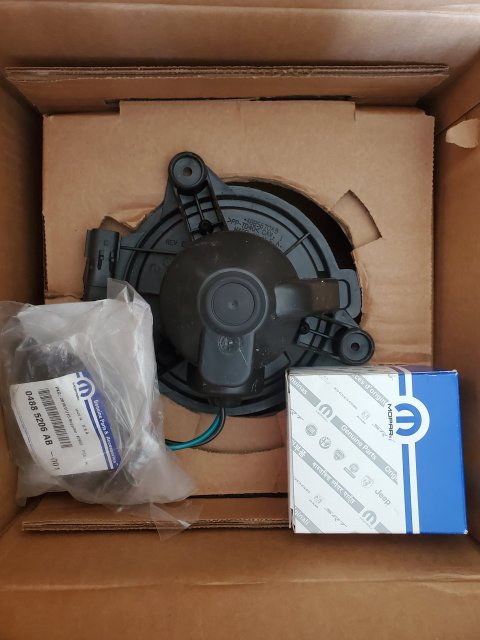

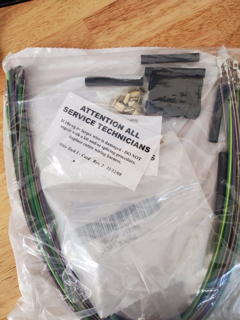

Ordered OEM blower, resistor, wiring harness (coming Monday), and supplier (climate control clicks and sticks when changing temperature). Hopefully I have time to fix this week before my trip on Sunday.
Hoping all OEM is the trick...wasn't cheap.
