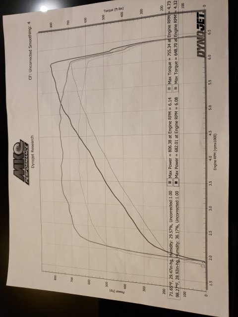

hello all,
i wanted to post my new results with the upper pulley installed. prior modifications innovators west lower, demon injectors, stainless works cat delete.
quite impressed with the new power. tuned on e20 fuel

E20?

yes, have also ran e30 as well

Didn't know that was a thing being that low. Why not go e85?

unfortunately not in the budget at this time.

Highly suggest e85 and a pulley down. I have a 2.79 and 2.69 im selling, one used 3 months, the other 2 dyno passes. Should be able to hold more boost with your current fuel than a 2.95
