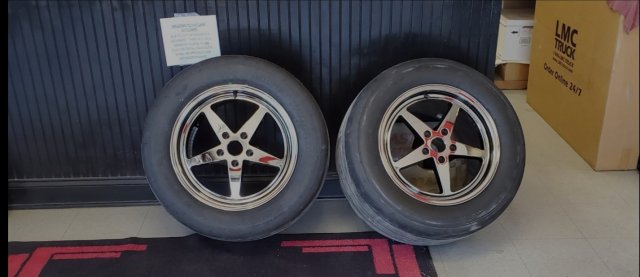

I have some JMS Avengers. 17x10. I mounted a set of MT 305/35r17's and ran the car at the track for 2 passes. I sold the car and tires, but I still have the wheels and lugnuts. They are chrome. I'd let them go for $300 for the 2 wheels and nuts. I'm in NC.

thats good deal and I appreciate you letting me know. But I'm looking at VMS wheels there price isn't bad I may go that route.
