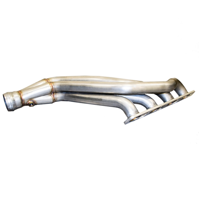

You should post pics of the headers. The pic I found shows lots of room. Only bolts on a 392 I did from the top were the front 2, all the rest were done from the bottom

That pic is the drivers side header. I’m not worried about that one. It’s the other one haha.
I’ll get some pics when I get to the shop

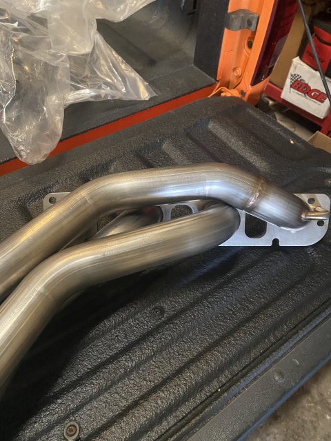

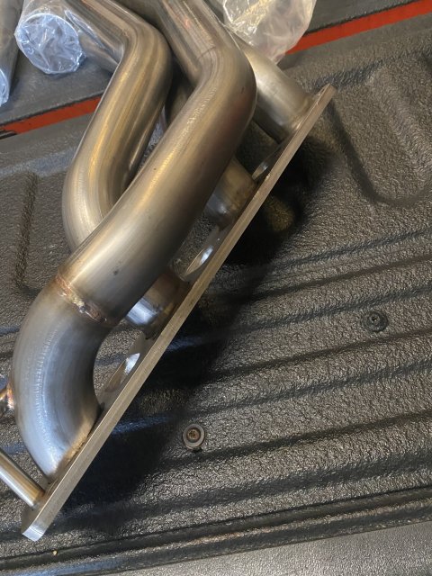

I’ve had these headers on the shelf for over a year. Since before I had the car even. Had some time and a helping hand so.......

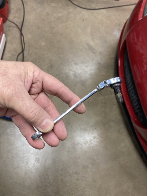

Get a flex head gear wrench, 10 mm is the ARP bolt size, I think stock is same size as well
