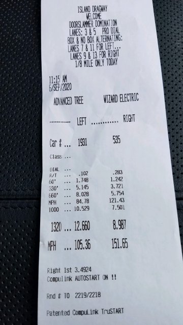

Z inspired me so I went to a track today to see if I could come close to his 60 foot with 700 less RWHP. Time slip is below, boost only, off the trailer, 6.2 L motor, stock blower (no porting), stock A8 including torque converter, stock 2.62 rear (welded up). Tuned by Eric @ EMP.
That is launching in 1st gear. This is my birthday present to Eric.

Nice job Cole! U need to send that trick to me, on those 60s!!!

Well Z gave me a wake up call, he crushed my A8 record and his 60 foot says it all, he has serious big time power. I run basically a stock drive train so I got to make the most of it. Switched to a 2.55 upper (from a 2.65), it does not yield more boost, however gives me more torque on the hit. I have less than 900 RWHP on boost, that is all anyone is going to get out of a stock 2.4 blower so got to make it count.
Ohhh of course a killer Tune is needed

radial pro 315, IMO best tire for heavy cars, however, they stick out on challengers, may tuck in on a charger.

Incredible launch. Well done

Hell yeah. Getting it done.
3,612
11,637
Good job!
I'd love a 1.35 sixty foot never mind a 1.24 lol
