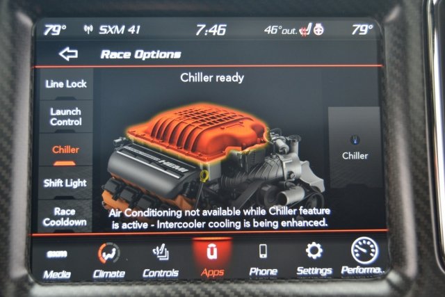

Saw this picture online today, and it makes me think they've permitted the use of the killer chiller while not in track mode. Anyone know if they can update the computer in my 2019 Redeye to permit this?

This was discussed in another thread here. @DRAGRCR has a 2020 Redeye and confirmed that the 20's use a button for the chiller instead of track mode. So the 2020 models can run the chiller in any mode. I have a 19' RE as well and I would like this switch! I've called SRT Hotline and spoke with my dealer about it. Dealer knew nothing (no surprise there), and SRT Hotline didn't know much either. Just said IF they made a flash upgrade we will have to wait awhile since the 2020 models are just coming out. While I would like this change, I wouldn't hold your breath that they will give it the to 19's. It would be awesome if they did though.

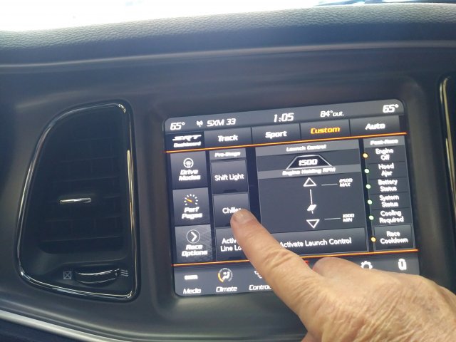

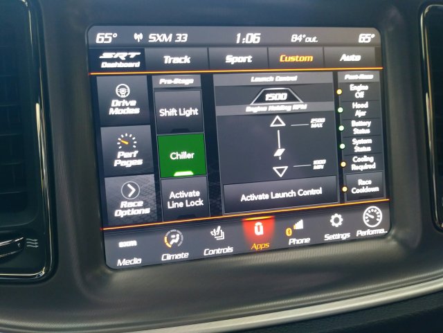

Yes. My routine is start car, put it in drive then manual on the trans then I hit the SRT button once and you land on the SRT Dashboard and then I hit the chiller button and put the car in Custom Mode by hitting the soft switch at the top of the page. 0423201305.jpg 0423201306.jpg

Awesome. Thanks both for the feedback. I like how everything is on one page. That's one of my pet peeves at the strip. I have to keep jumping from page to page and it seems like everyone is waiting on me. Please God, let this become available to us 2019 owners.

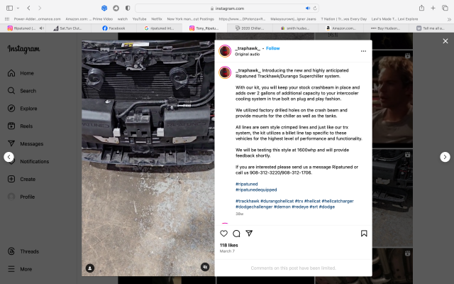

Make sure u insulate the lines behind the bumper before u put it back on. I would look at the Chiller from Ripatuned it has built it reserviors built right into the bumper.
